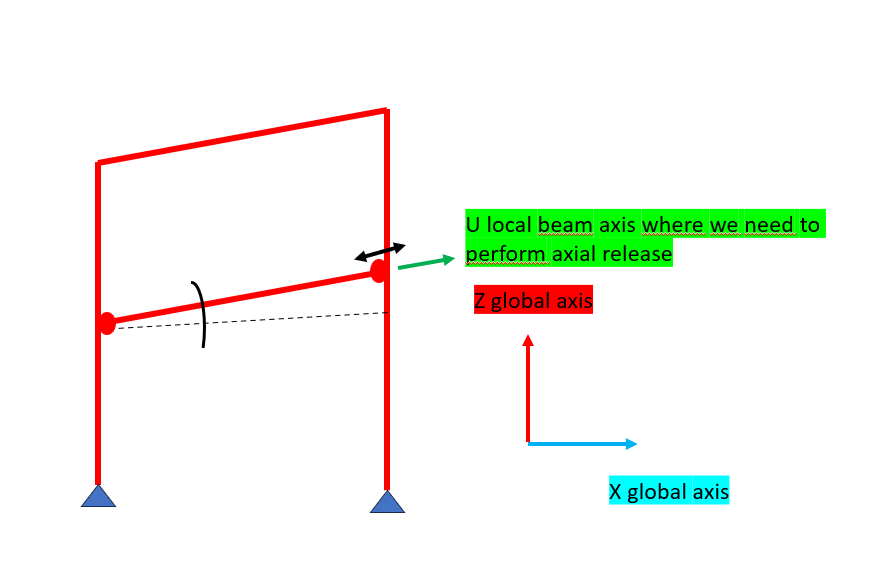

  • hi Victor, for the next update it will be great to access to CodeAster Solver and more important for the steelframe design it will be great to have all axial and transversal releases between beams (UU, UV, UW) avaible we can't use contraint equation for element which are not well oriented with (U,V,W) global axis such as a roof beam for example.
    I don't know if there is another tricks to avoid this issue

  • @sofien_73 I should be able to add translational DOF releases in v35.
  • Is there any steelframe example in which the issue with not well oriented elements generate an issue with constain equations?
  • thanks a lot Victor,
  • @disla I'm speak under control of ourselves but prior to the manual the displacement are in accordance with the global axis where beam release are in accordance with local beam axis system here on attached file the example which make me trouble
  • Nor sure if I understand the problem. The only Bug documented related to this was BUG "Bug 49: Constraint equations on beam elements with the CCX solver may cause unrelated constraints to be released". It is not in version 34.
    Are you talking about internal solver or ccx?. I guess you plan to release rotations to do hinged connections?
  • Hi Disla, I was speaking about axial releases between two beams on internal solver.
