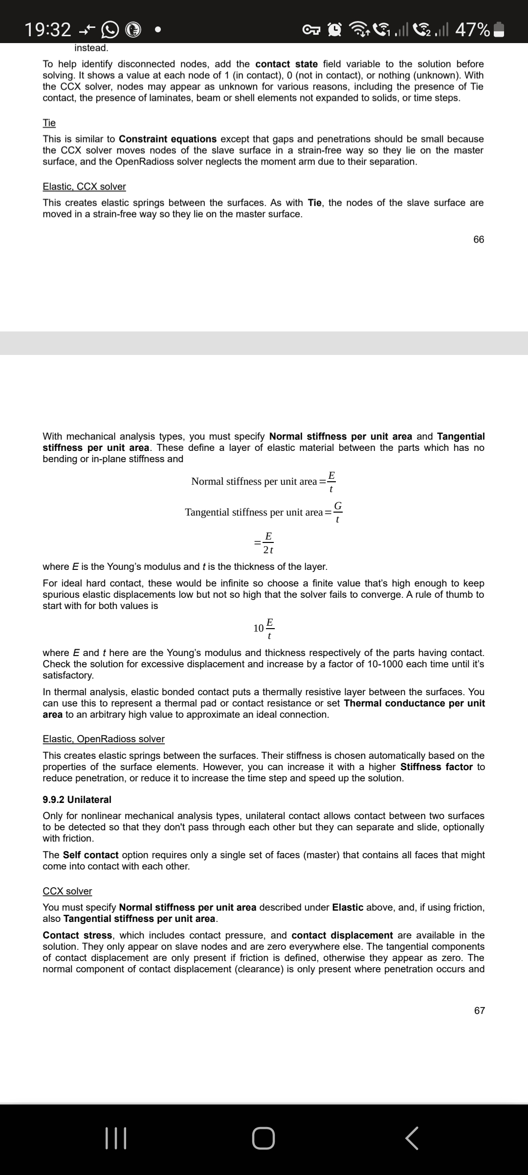

  • There is a section in the manual on contact stiffness. Not sure thats what you mean?
